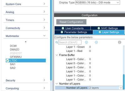

I am trying to create a basic setup for STM32L4R9-DISCO with CubeMX and TouchGFX.
TouchGFX complains about more than one layer being active from the LTCD module.
But I cannot figure out how to disable a layer in the LTDC.

2024-03-22 9:53 AM
Simply open MX click ltdc and switch to one layer mode
2024-03-25 12:14 AM
Thanx! How was I able to overlook this :)
