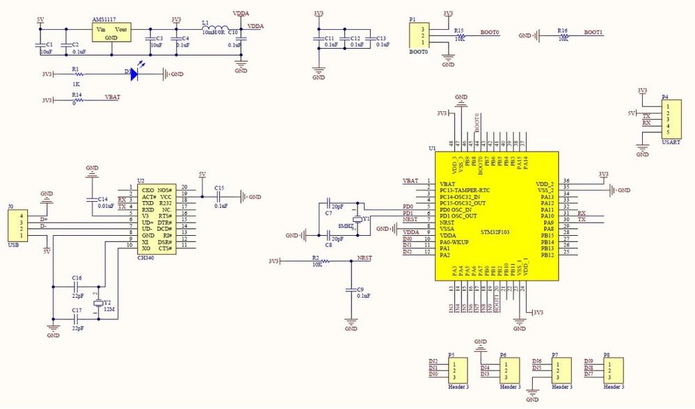

Does the board come with a schematic or instructions? Please link to those or attach.
2020-12-08 5:38 AM
2020-12-08 8:50 AM
NOYITO USB 10-Channel 12-Bit AD Data Acquisition Module STM32 UART Communication USB to Serial Chip CH340 ADC Module
The viewer was annoying, so grabbed and attached at best resolution I could.

Hello, I managed to solve my problem.
I've used a USB to Serial chip connected to MCU, BOOT0 connected to 3V3, and STM32CubeProgrammer in the UART mode; I've downloaded the .bin file of my project and I've programmed my device. Now it works correctly.
