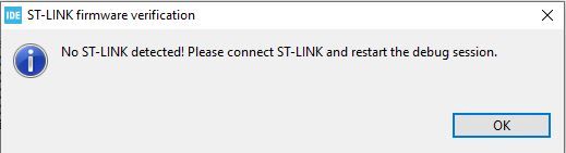

Does the ST-LINK show up in Device Manager? Get the Windows Ding-**** sounds when inserted/removed?
Try different cables, different ports.
Avoid hubs and docking stations.
Don't use charging cables.
2020-10-21 12:54 AM
I don't use charging cables or hubs or docking stations: I've connected directly the device to the USB port of my PC. I've already tried to connect the device to different port, but the problem persists-

Hi, I've tried to uninstall the old version and install STM32CubeIDE 1.5.0; I've installed all ST-LINK driver (I think!), and I've tried to update ST-LINK Firmware, but my problem persists. Have you got an idea?
Thank you for helping me.
2020-12-03 10:34 AM
Does the ST-LINK show up in Device Manager? I don't recall getting a yes/no answer on this.
Is this a laptop? DELL? Corporate?
Are there any policy settings preventing USB MSC being plugged in?
What ST-LINK do you have? Official one, boot-leg?

I'm trying to program this object:
The micro inside is STM32F103C8T6, but I receive the ST-Link message error.
2020-12-05 7:41 AM
this device does not contains STLink but communicates with USB-Serial portocol.
Debuging with USB_serial port is imposible.
It is posible to program MCU by using STM32CubeProgrammer in UART mode and pulling up BOOT0 pin (jumper).
