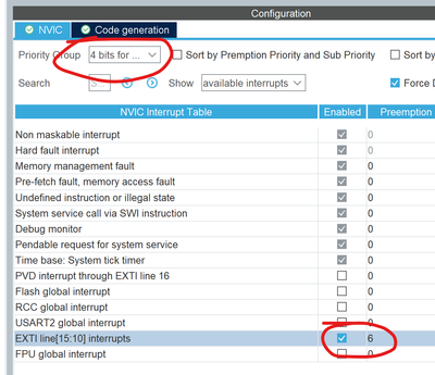

It's possible to set an interrupt priority for a pin in STM32F411 MCU, right?
My PC13 pin (user button) is set to GPIO_EXTI13 and I want to give it the preemption priority 3 in the NVIC (STM32Cube IDE ver: 1.18.1) but it's seemingly not possible!
Its value is zero and immutable!
Here's a screenshot:

You have 0 bits for preemption selected, so 0 is the only preemption priority available.
Change the priority group to have preemption bits and you can select something other than 0.

Click the dropdown to change it. Include your IOC file if you're having trouble.
