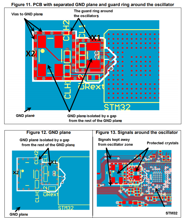

2. Recommendations from STMicroelectronics
The chip manufacturer recommends to provide a separate local GND-plane underneath each crystal. This GND-plane must be tied to the nearest GND-pin on the chip. I got that from Application Note AN2867:
The following figure is from that document:
You can see two crystals on the figure: X1 and X2. Each has its own local GND-plane, separated by a gap from the overall board GND-plane.

2018-10-24 10:53 AM
Hi @Community member , I looked for the gerber files of this NUCLEO-F767ZI board. With a gerber viewer, I discovered that the general GND-plane runs under the oscillators as if they were no different from any other component. They definitely don't have their own local GND-plane.
Why is STMicro not following their own advice?

2019-05-30 4:43 AM
Probably because the ST person didn't read their own app-notes. This whole thing of how to protect crystals from noise began in the 1960/70s (Bob Pease possibly ?) and I've been following it every since then so the app-note is correct, the designer was wrong. You can usually find a way to put the protective ground around the resonator in every case I've seen.
