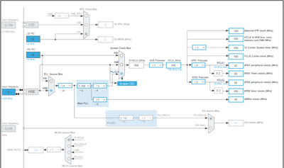

clock configuration:

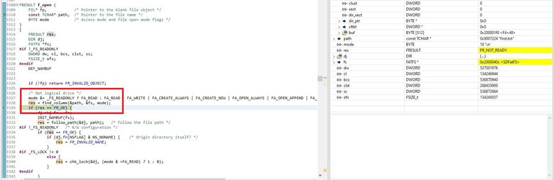

2024-09-19 4:46 AM
After reviewing, I found that the problem is generated when the find_volumen function is called, what is the cause?
