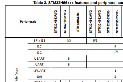

one possible chip: H562/3 :
2 SAI + 3 I2S .
Look yourself at the chip selector....many have 3 SAI (H7xx) or 3 I2S (H562/3 ).
