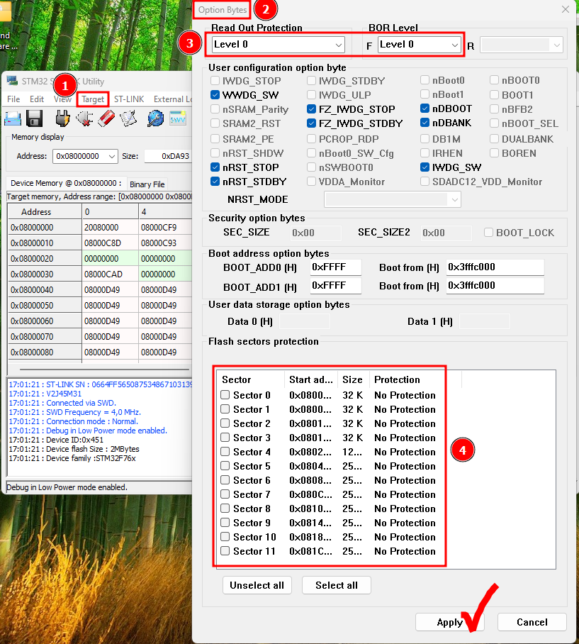

After my experiments with Flash, I got an identical problem. How I fixed it is, see screen

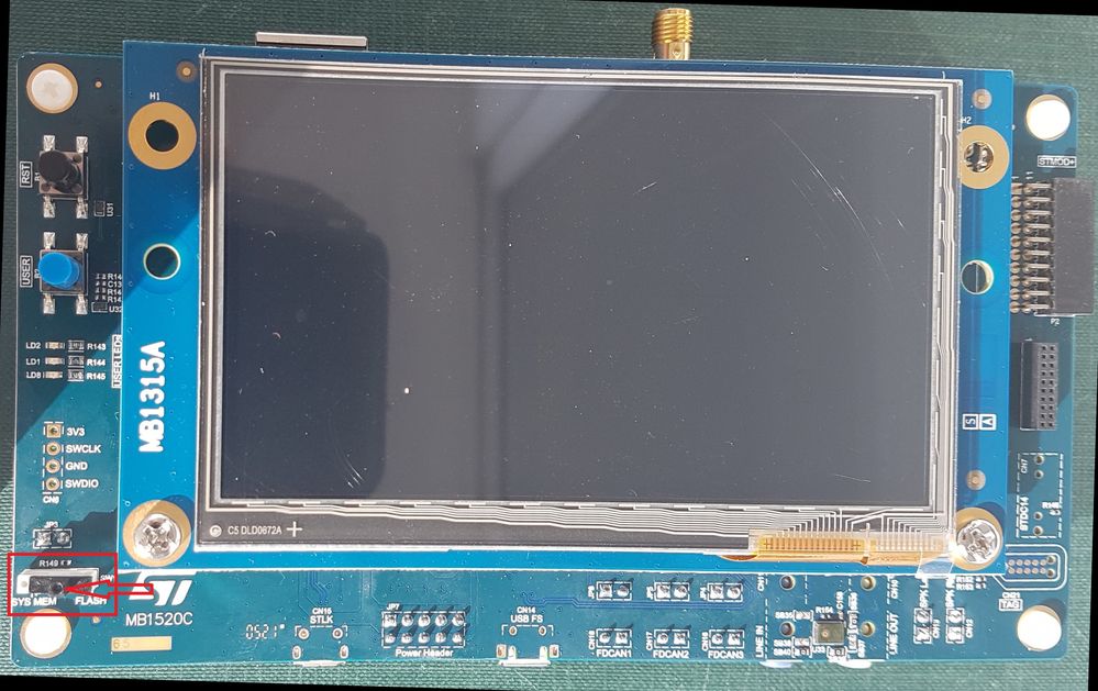

I had this same problem on the STM32H735G-DK and reason of this was a wrong firmware uploaded which blocked SWDIO. All the time ST-LINK-V3E put file named "FAIL.TXT" in the mass storage device entries.
Solution:
Change BOOT switch (showed on the picture below) to SYS MEM possition, plug ST-LINK to USB (now on MSC device doesn't exist "FAIL.TXT" file), run STM32CubeProgrammer and do full erase of MCU flash. Now change BOOT switch to FLASH mark and everything is all right after reset.
