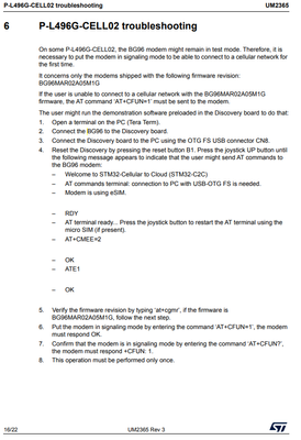

quectel bg96 does not reply to messages from stm32l496ag on kit board p-l496g-cell02 but since I bought it. I could not even start blink the led on bg96 so I assume there is something missing to me. I use usb cable to stlink com and debug from the software but never had a response from bg96 after sending at commands. What I can do about? thank you. Marcello

I advise you to look at UM2365 precisely "6 P-L496G-CELL02 troubleshooting" section and follow the recommended steps.
I hope this help you to solve the issue.
Thank you.
Kaouthar

Hello @marcell029 ;
As mentioned in the UM2365, the demonstration is preloaded in the discovery board.
Also, you can use X-CUBE-CELLULAR | Product - STMicroelectronics to enable the SIM MFF2 soldered on your BG96 Module with your P-L496G-CELL02.
