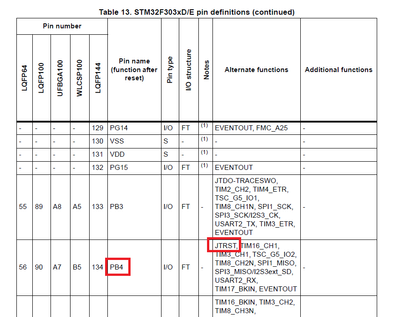

2024-12-01 8:07 PM
According to datasheet of STM32F303ZE, TRST is on PB4. Could you double check?
