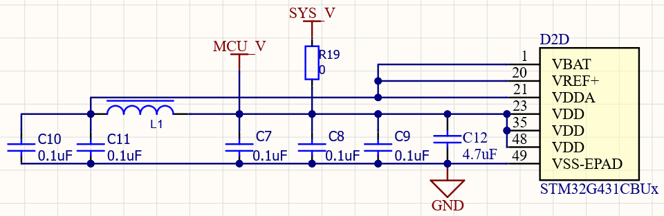

Hello. A have my custom board with STM32G431CBU microcontroller. Power domain on my board are shown in the picture:

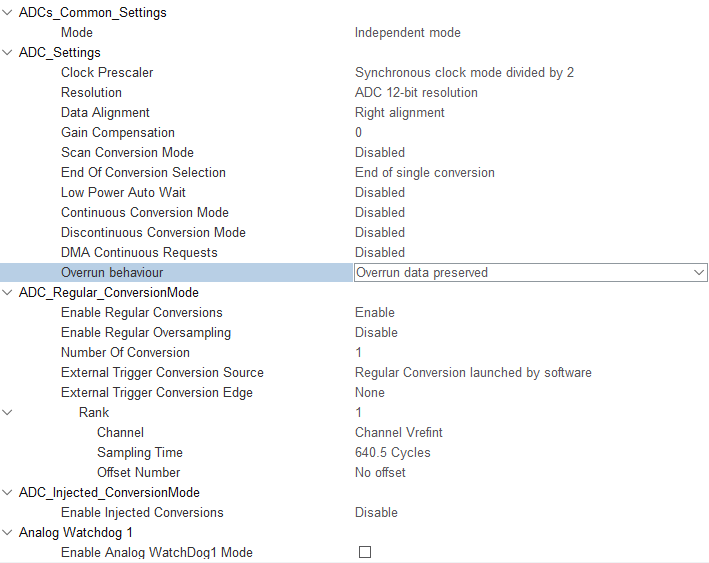

I want to measure the voltage on Vref+ pin. The analog domain settings of CubeMX are:

After start and initialization of all periferial i insert delay 1 s. I think this is enough to set the VREFINT value. I seted the maximum posible sampling time (640.5 cycles), ADC clock prescaler is 2 (as mentioned in the picture above). SYSCLK on input of ADC is 16 MHz.
