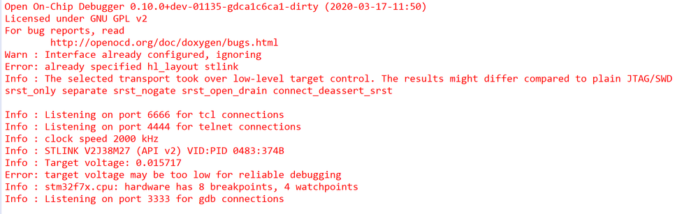

I'm a STM32 beginner and i'm trying to reconnect a Nucleo-F767ZI with the cut ST-Link. I'm working with ChibiOs and i get the error: target voltage may be too low for reliable debugging. But i get some kind of communication (LD1 shows red and green)
I'm using the SWD Port on the ST-Link and an external 5V powersupply (E5V) and I connected the SRT-Link like this: SWCLK to CN11 pin 15, SWDIO to CN11 pin 13, NRST to CN11 pin 14, VDD_Target to CN11 pin 5. I also detached the Jumpers CN4 on the ST-Link and got the Jumper JP3 to E5V.

For some reason, the ST-Link report that it cannot sense properly the target voltage through VDD_Target pin.
Check voltage CN11 pin 5, and make sure the connection is OK.

Thanks for the fast reply. I Checked the voltage on CN11 pin 5, it is 3.3V and all connetctions seem to be fine. Also the ST-Link firmwareupdate did't change anything. I'm still getting this Message:
2021-09-14 5:55 AM
By the way, I don't know your setup, but the error message is talking about JTAG, when you're trying to use SWD.
Other thing is ST-LINK V2 2000KHz is not a frequency that I know.
I know 4000KHz, 1800KHz
Can you post a picture of the setup especially of the ST-Link probe ?

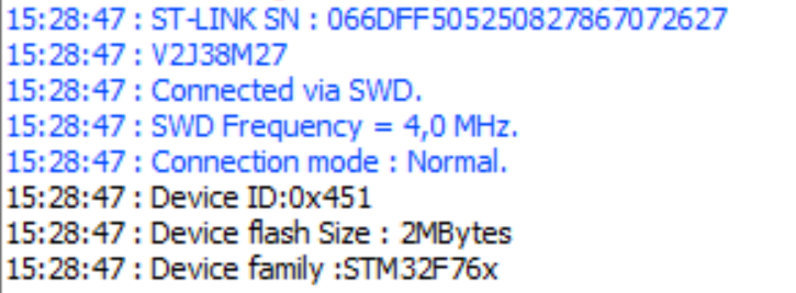

I'm not able to post a picture today. I'll try to do that tomorrow. But I tried to check the connection with the STM32 ST-Link Utility Program and this is what i got:
Is it possible that my setup is correct, but there's something wrong with my ChibiOs files?

Ok, so your hardware setup seems to be fine.
By the way, please use STM32CubeProgrammer instead of ST-Link Utility,.
STM32CubeProgrammer displays Target voltage after connection.
Yes If the OpenOCD config is wrong, it won't work.

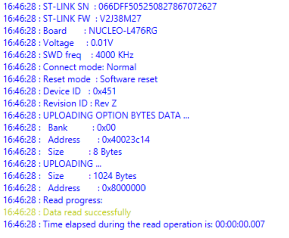

I get these with the CubeProgrammer:
The Voltage is still too low tho....
Maybe there are some soldered bridges i might need to detach?
2021-09-14 8:10 AM
Ok, I found a nucleo F767 somewhere, and I see that R1 is set as N/A on the schematic.
Please fit R1 with 100 Ohms if you can.

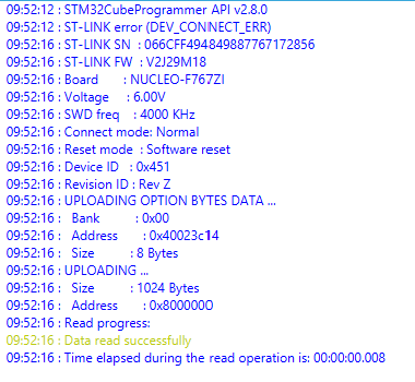

I fitted R1 with 100 Ohms now an this is what i get now:
But 6V seems a litte high for me, or am i wrong?
