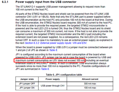

@srinath wrote:also mentioned to take care that input should not exceed 100 mA.
Are you referring to this:
Again, that is talking about how much the Nucleo board (and any attached shields) draws - which has nothing to do with the current rating of the power supply (eg, the 2A on your powerbank).

yes I am referring to this , Is it the max current allowed ? and my load will be around 500 mA . If I put the jumper J1 on and connect the power supply to power band using USB , does it able to draw the current ? and any tips and suggestion will most welcoming and thank you the quick reply.
2024-02-01 1:54 AM
Did you read the bit about the USB Enumeration?
That explains the 100mA limit.
Almost certainly, your power bank won't do USB enumeration - it just acts like a dumb power supply.
