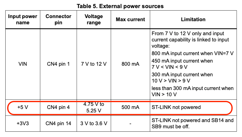

One more question: does the SB9 need to be removed when connecting battery to +5V (and USB not connected)?
In manual, in the table it does not say that it needs to be removed.

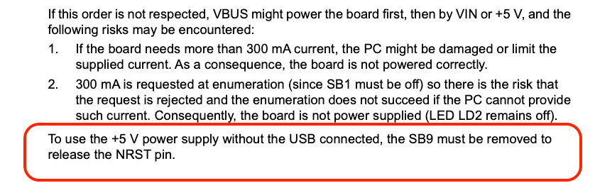

However in other place of the manual it says that it must be removed.
Looking at the schematics, I think that when SB9 is ON and USB not connected, then reset will be permanently ON. But I'm not sure about that.
If you want to supply the NUCLEO-L432KC exclusively via +5V (CN4.4), the embedded ST-LINK receives no supply voltage due to D3 and D4, so that its output PB0 (T_NRST) is undefined and is usually read as low. For this reason, the second sentence you framed recommends removing SB9 so as not to block the target.
