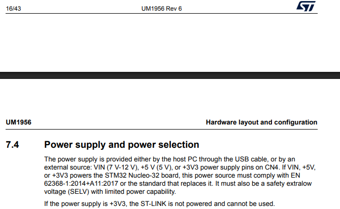

The User Manual tells you what the possible power supplies are ...
https://www.st.com/resource/en/user_manual/um1956-stm32-nucleo32-boards-mb1180-stmicroelectronics.pdf#page=17

According to the documentation, Nucleo can be powered from source which gives 3-3,6V or 4,75-5,25V. The li-pol battery has 3,7-4,2V. What would you suggest to do, to power the Nucleo from the li-po battery?

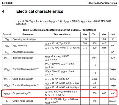

It looks that +5V goes to LD39050PU33R, which has operating input voltage 1,5-5,5 V. That means that indeed I can power Nucleo from lipo battery via this PIN.

More important would be the dropout voltage - ie, can it maintain 3.3V output regulation when the input is only 3.7V.
(that might not matter - so long as the output doesn't drop below the minimum operating voltage of the STM32L432KC, and/or anything else on the board)
PS:
It's 400mV max - so you should be OK:
https://www.st.com/resource/en/datasheet/ld39050.pdf#page=7
