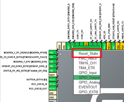

It's possible to use CAN on this board over PB8/PB9 pins.
You need just to reset the pins for I2C function and activate CAN1.
Attached an ioc file where CAN1 is enabled.

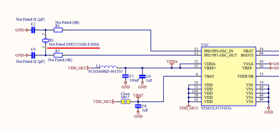

But becarefull: you need to use HSE with an external cocurate clock source for example a crystal . Internal oscillators are not recommended for CAN communication in Normal mode.
According to the schematics, the 8Mhz crystal is not fitted, so you need to solder one:
Hope I answered your question
