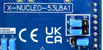

It looks like it gives a choice of I2C or SPI:
both of which are buses - ie, can be shared by multiple devices.
