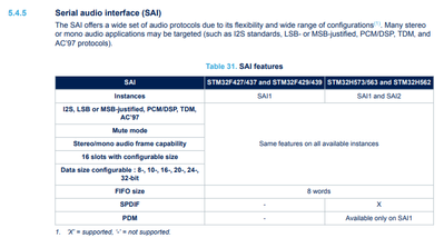

Hello @Nagarajan ,
I advise you to have a look at this application note AN5688 which provides guidelines on both hardware and peripheral migration from STM32F4 to STM32H573/563 and STM32H562 MCUs.
Make sure that your STM32H5 board supports the required audio features.
