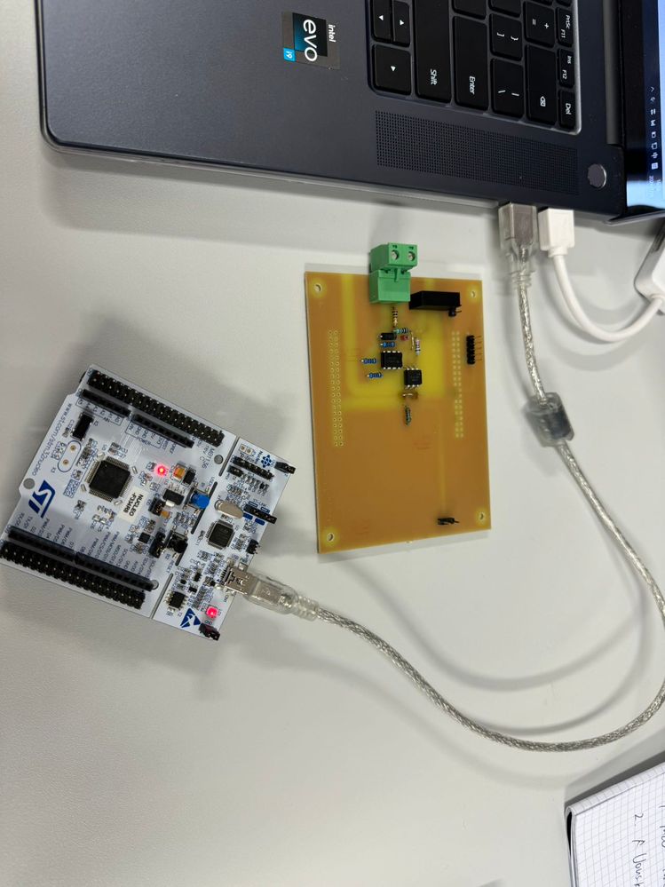

Hello community,
I’m encountering a challenging issue with my STM32 setup that I’m hoping to get some insights on. When I mount my microcontroller onto another PCB and connect it via USB, the board overheats near the USB connection and the LD3 (power LED) does not light up. I only soldered the 3V3, 5V, and GND pins on this secondary board, where 3V3 and 5V are used to power peripherals.
Here are the symptoms:
My initial guess is that there might be a power supply issue or a short circuit involving the 3V3 and 5V pins used to power peripherals, possibly causing insufficient power delivery or overheating due to improper load handling.
Could anyone provide guidance on how to properly manage power distribution in such a setup? Any suggestions on troubleshooting steps to isolate and resolve this overheating and power failure issue would be highly appreciated.

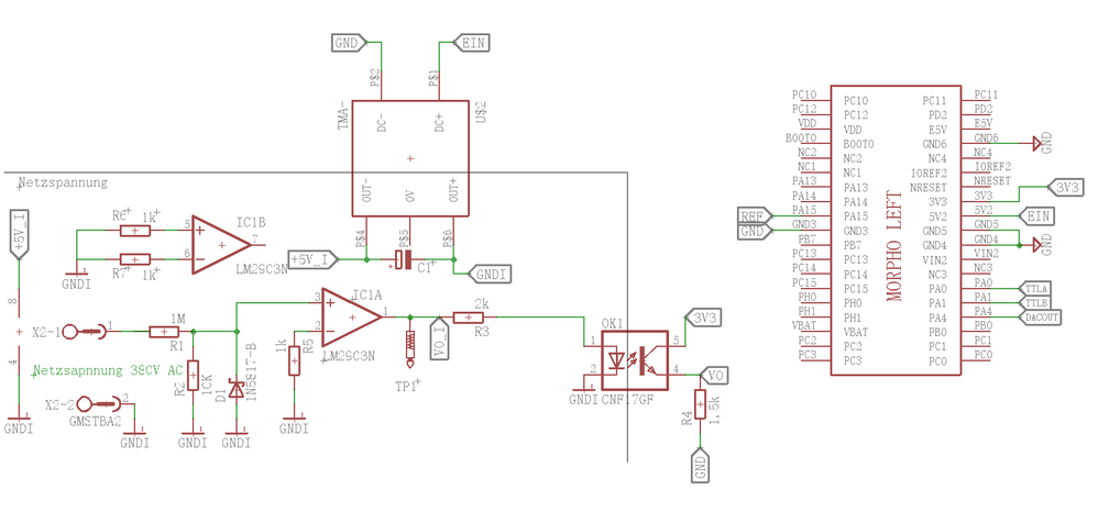

2024-07-11 6:20 AM
Hallo Peter,
thank you for your suggestion. The circuit diagram of the PCB board is as follows, with 5V and 3.3V labeled as labelEIN and 3V3 respectively. The 5V will serve as the input voltage for the DC-DC converter, which will ultimately supply 5V DC to power the comparator. The 3.3V is connected to the right side of the optocoupler to output zero-crossing detection voltage at the VO point.
When the extension board is on the PCB board, I connected the CN1 of the extension board, which is the STLink port, to my computer. You can understand it this way: the PC powers the extension board, and the 3.3V and 5V ports on the extension board supply power to other components. The LED is the one lit up at the bottom of the first picture.

2024-07-11 7:05 AM - edited 2024-07-11 7:07 AM
The picture is slowly becoming clearer.
Since you haven't specified the type for the DC-DC converter, no one can estimate the current it draws - please check it.
By the way, your zero-crossing detection with the LM2903 will not provide any pulses. The LM2903 is a comparator with an open collector output. Therefore, in your design the LED in the optocoupler will receive either GNDI (0V) or floating = 0V as input voltage from the LM2903.
You might be able to:
However, such optocouplers do not want to see just 1mA of current, but 10mA, so you should change R3 from 2k to 180...220 ohms to provide sufficient current for the optocoupler.
2024-07-16 7:25 AM
Hallo Peter,
thank you for your valuable advice. Yes, the zero-cross detection circuit was missing a very crucial resistor between pins 1 and 8 of the comparator. It wasn't shown on the circuit diagram, but I did solder a 1.8k ohm resistor on my own board. I improved the current flowing into the optocoupler based on your suggestion, and the test results were good. The overheating issue was due to the wiring on my PCB being too close, leading to a short circuit, which is now resolved. Anyway, thank you very much for your help.
