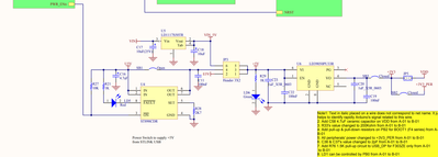

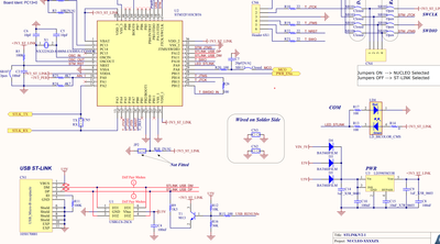

Pull a schematic via CAD Resources tab.
2023-08-19 10:37 AM
i got the schematics but from where to start? I suppose it is something from
this parts not from the real mcu. still i am in a not comfortable situation here. if something was to be burned what wound have been first in order the led to start light?
2023-08-19 10:52 AM
I don't recall what it is sensing, perhaps undervoltage. Start by following the current ingress pathways. Perhaps get a USB current meter and see if that's pulling excess current.
