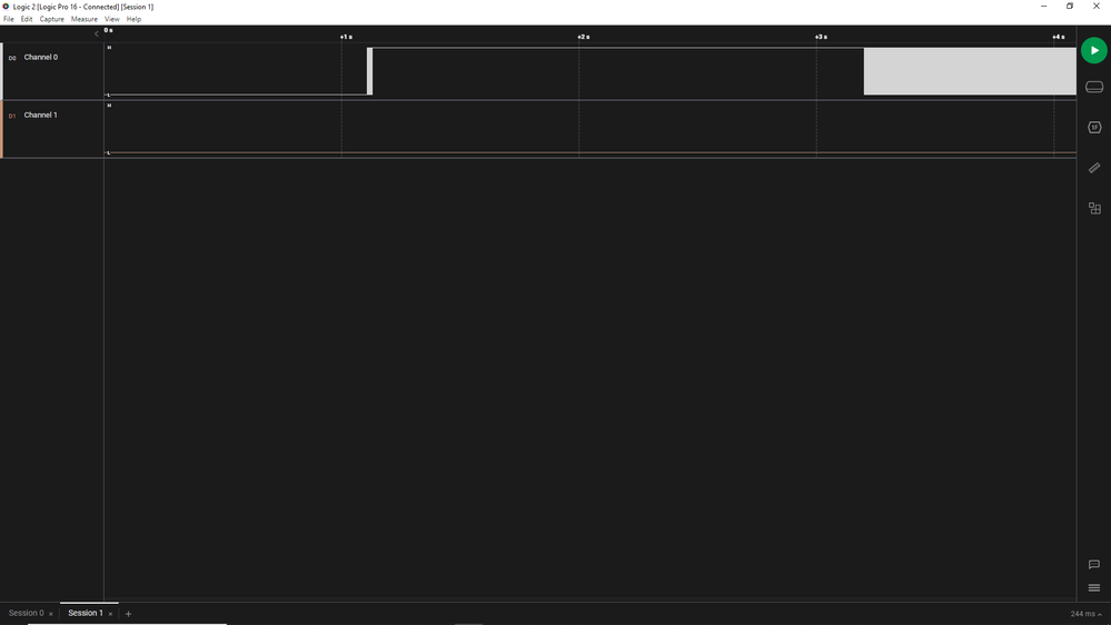

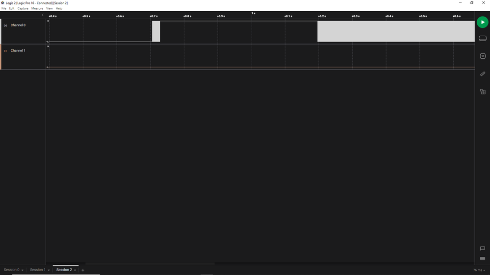

I think now I am starting to understand the 2 second delay after I hooked up a logic analyzer:So if I could just figure out how to delay the hse timeout it could work.
2022-12-05 6:07 AM

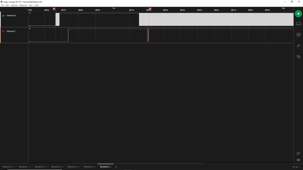

That post was with basically a dumb usb power and this capture is a usb host:
This one has about half a second delay

So here is another capture. The CPU is getting reset after the ST-link starts sending a clock pulse. That doesn't make any sense to me then why it is not booting up. Any thoughts?
