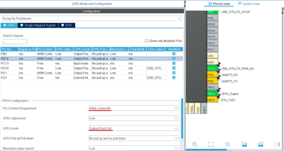

2025-08-07 8:38 AM
Ensure it is assigned a core context and is being initialized as a GPIO output.
If in doubt, look at the GPIOB register and ensure MODER bits are as expected.

2025-08-07 9:01 AM
Share code, ioc file, if you can.
Use a voltmeter to check PB14 output on CN8. Q3 transistor or LD3 LED might be non working.

2025-08-11 8:20 AM
Hi @Mike_ST ,
Do you have any recommendations for addressing this issue?
