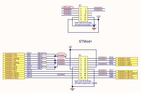

I'm using STM32H747I-DISCO bord.
According to user manual, Pin No.1 in Pmod™ is connected to PA11/PA0.
And Pin No.1 in STMod+ is also connected to PA11/PA0.
Then can I use PA11 as USART1_CTS via Pmod™ Pin No.1, and PA0 as GPIO via STMod+ Pin No.1 concurrently?
Thanks in advance.
2025-08-13 3:26 AM
2025-08-13 3:26 AM
No You cannot, the two pins are connected together:
