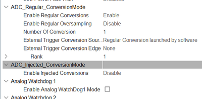

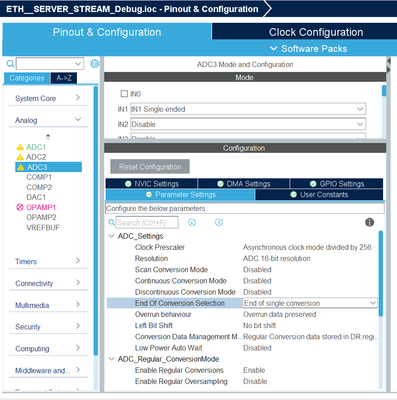

2024-01-05 1:55 AM
"Enabled" means i simply enabled the ADC in the CubeIDE configuration panel. I uploaded a picture of my config below so you can see.
I indeed suspect there is something wrong with my setup but cannot pinpoint it.
I managed to make the ADC module work without problem in the past, so my best guess is that I messed up something with the LWIP.
