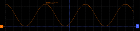

During sine generation using DAC, there is no offset of this voltage observed and the output is in range.

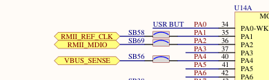

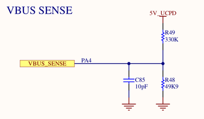

from circuit of Mb1404 , PA4 is connected to VBUS_SENSE .
So open SB56 , if you dont want to use vbus-sense or need "free" PA4.

Have you checked the schematics?
eg, is there anything connected to that pin related to the User USB?
2025-09-24 3:08 AM - edited 2025-09-24 3:10 AM
