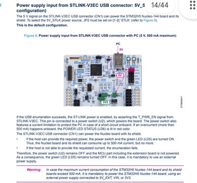

If you are sure about your USB cable (is a data cable and not a charging cable) and USB ports, i suggest you to try to connect your board to CubeMX using different connexion modes (under reset SW and HW, hot plug,...). You could also check the following part of the UM3115:
