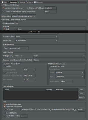

The debug configuration looks like this:

Just wondering why Access port is set to "Cortex-M3" while it needs to be "Cortex-M33"?

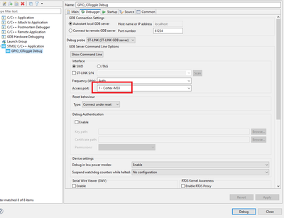

If you try any STM32CubeIDE project example from STM32H5 Cube package and go to Debug Configuration you get (from GPIO_IOToggle example):
That's a great question.  I looked at my colleagues Debug Configuration again and his is indeed set to 1 - CortexM33. The only option I have is 0 - CortexM3.  I imported the project using the .ioc file.  I went back and checked the project I built using the NUCLEO-H503RB and noticed that I had a second project open in STMCubeIDE and it was the one launching when I was trying to debug.  When I closed the other project I am indeed able to launch and debug the sample project.
So I think this gets me half way there.  Two open questions.
1. How do I change this to 1 - CortexM33 if the option is not available.
2. More importantly, how do I open and existing working project that is created on a colleagues computer and get the correct settings so I don't spend 5 hours trying to get the debugger to work in the future.
