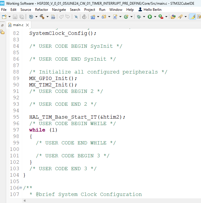

Hi, actually, I want to generate a 1 microsecond (1 µs) timer interrupt on the STM32G0B1RCT6  microcontroller using their internal clocks.

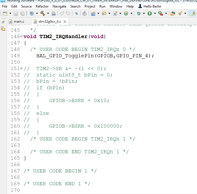

For the STM32G0B1RCT6 controller running at 16MHz APB timer clock, I set the prescaler value to 0 [16MHz clock frequency / (0+1) = 16MHz counter clock -> 1/16MHz = 62.5ns counter period]  and the counter period to 15 [ARR is set to 15: 62.5ns*(15+1)=62.5ns*16=1us]. This configuration is intended to represent a 62.5ns  interval once the counter starts counting. I then set the ARR (Auto-Reload Register) value to 15+1=16. However, on the oscilloscope, the interrupt is generated every 4.24 microseconds. Could you explain why this is happening and tell me the correct values for the prescaler and ARR?
i'm not using only hal Drivers,i will attached the screenshotScreenshot 2024-06-05 135203.pngScreenshot 2024-06-05 135133.png for your reference.

Each code snippet consumes one or more clocks of time.
If you do not directly manipulate the addresses, the HAL library will spend extra time with its internal checks etc.
Below are a few code snippets from the Hal library.
When you examine these codes, you can see that it is not strange that the code you wrote takes 68 clocks.

If I do not directly manipulate the addresses, the HAL library will spend extra time. Okay, now I understand. Can I configure TIM2 to generate the code, and manually configure only the pin I need to toggle every second? Can I achieve a 1 µs delay?
