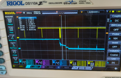

2025-08-21 10:56 PM
Blue is Rx and Yello is Tx. There seems no pull up on Rx, so it drops when UART cable is disconnected.

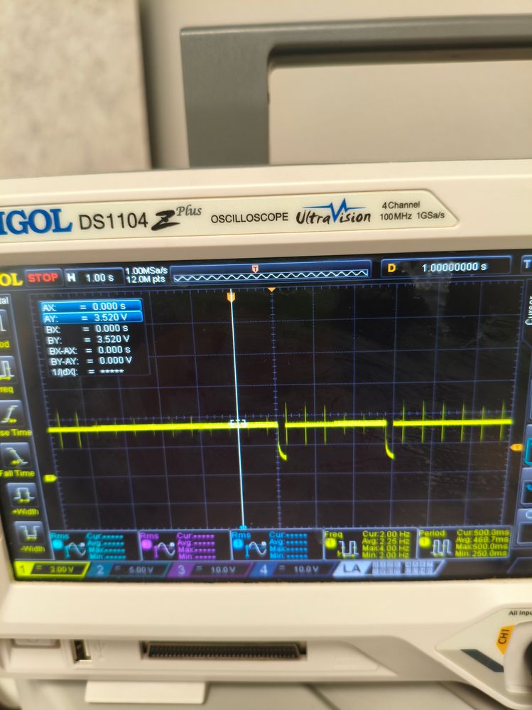

Hi Mike
I tried to use the internal pull up and got below behaviour. It seems still a voltage drop for a short period of time when I disconnect uart cable. Is it normal ? And I can see vertical noise that is synchronized with Tx timing, which is probably due to coupling ?
2025-08-26 1:43 AM
>> I tried to use the internal pull up and got below behavior. It seems still a voltage drop for a short period of time when I disconnect UART cable. Is it normal ?
Can't tell.
I have never analyzed plug/unplug events on a serial line.
I'm not sure what I'm seeing on the scope, what kind of event it is, at what time stamp, and where the probe is connected.
Is it a RX+GND disconnection, or is it just the RX wire ?
Probably.

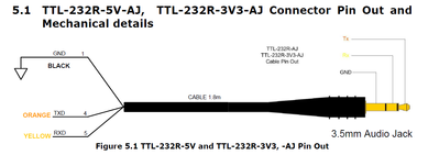

2025-08-26 1:12 PM - edited 2025-08-26 1:14 PM
What connector does the USB-to-UART cable have on the STM32 end? Is it one with the tip.ring/sleeve audio style connector (FTDI TTL-232R or TTL-234X cables)? If so, as you unplug that connector it can temporarily short the RX to GND.
EDIT: Like this:
