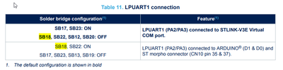

2025-08-27 12:03 AM - edited 2025-08-27 12:04 AM
TDK, thank you very much for your answer. You have rigth it was missing to "close" the SB18. Just for the others who could have also the same problem as me I post a screenshot from the UM2505 where it is commented. Thanks again!
