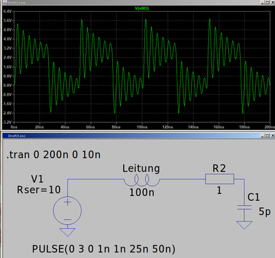

And here some pics to show, what comes out - just from physics :
20MHz 3V square , 1ns rise/fall , just looked with a scope probe (5pF load ! )

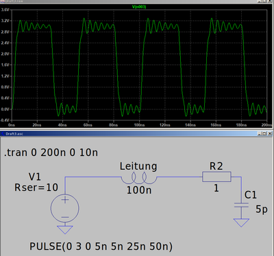

same at 5ns rise/fall time :

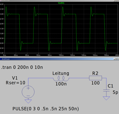

And with a 100 ohm resistor, to reduce ringing, also 1ns rise:
So if your wires > 30mm or so, add series damping resistors on all signal lines.
