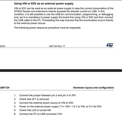

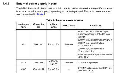

Check the user manual what power supply methods are allowed and what conditions apply.
Here a section from a Nucleo-32 manual of mine :

Power supply to CN7-6 (E5V)
JP5 to E5V (left)
JP1 not connected
I do not want to connect the USB (CN1)
