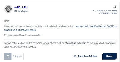

2025-12-03 5:34 AM - edited 2025-12-03 5:39 AM
I suspect you have an issue as described in this knowledge base article: How to avoid a HardFault when ICACHE is enabled on the STM32H5 series
PS: your project hasn't been uploaded.
