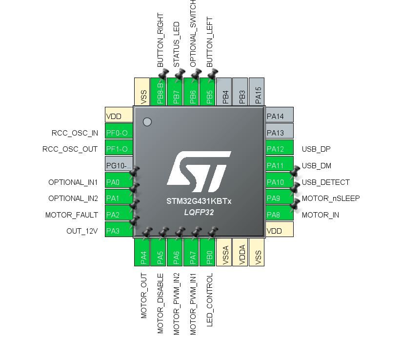

I build a prototype board based on STM32G431KBT6 which need Virtual COM port and DFU firmware upload. In previous version of the prototype everything worked fine.

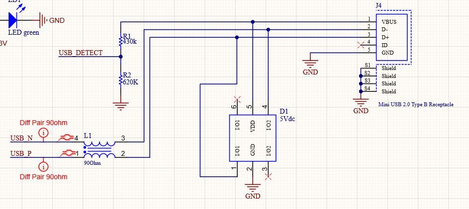

I'm wondering if I'm wiring it wrong.
Should I pull-up USB_DP ?
Are the USB_DP en DM pins on the microcontroller 5v tolerant?

I got the USB_DETECT pin from an example on the web, but I think I'm not doing anything with it at the moment.

What is L1 and what is D1?
Try to remove them (bridging L1 of course).
How is GND and the mcu's ground connected? Make sure they are properly shorted. Measure ground difference between your board and the PC which "kills" it.
2021-05-19 4:12 AM
L1 is a common mode choke and D1 is a TVS diode
Removing them didn't help.
I discovered the host pc is powered via a floating DC adapter and my prototype also.
I measure 86V! AC between PC casing and min pole of my prototype adapter.
Can I force two floating DC adapters to level there "grounds"? Or do I have a ground loop here?
