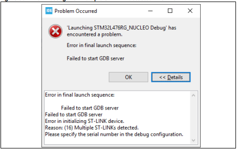

If you try to launch a debug session with two ST-LINK connected, a pop-up message appear as shown in the figure below:
Please refer to AN4989 and precisely Appendix C Managing various targets on the same PC/ STM32Cube IDE section.
