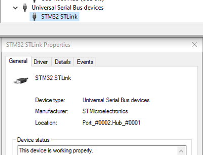

I want to program my STM32F091CC with the ST Link/V2 through Arduino. I downloaded the stw-link009 software and I can push Arduino code to the STM32. The problem is that I can not get serial communication so I can see serial prints or debug my code.
I have been trying to fix this issue for several days now but don't see a solution. On other forms I see that it is impossible to get serial communication from an "external ST Link/V2 ..
