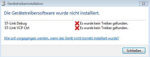

on win7 here :
no driver found.

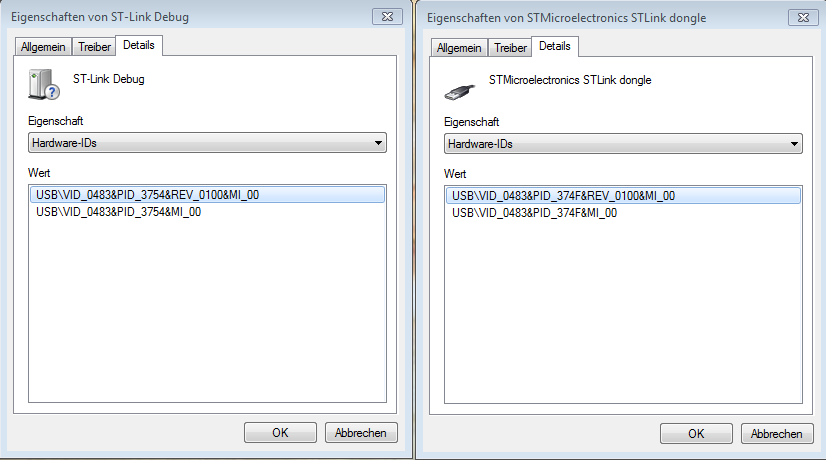

and compare on USB V3mods right and V3minie left side:
different PID .

Try to manually (in Device Manager) install the WinUSB driver on it.
(Update driver-> Browse-> Let me pick from a list of available drivers on my computer...)
Unfortunately Windows 7 is thing of the past (support ended) so - products are no longer tested against it.
For the VCP interface, Win7 does not have in-box driver for USB to serial adapters at all. Install the ST provided driver.

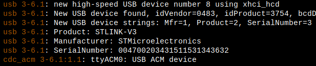

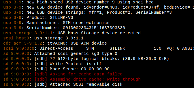

both connect and work instantly on linux ( MX 18 ) , 5 y old now , but updated ;
in linux it shows:
but V3mods shows a drive :
so V3mine has NO msc drive to flash something!

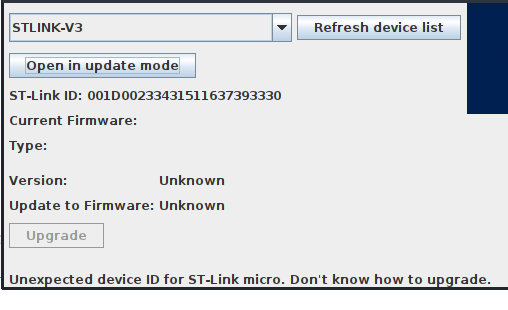

Bob, i tried now... (on Linux) and see:
ok , so it want update programmer first and then - maybe- new game . or not .

I am a bit concerned by the "Unexpected device ID for STLink micro" message at the bottom of the dialog box.
What version of CubeProgrammer are you using? The latest is 2.13.
Click on the "open in pdate mode" and see what it shows you for current version and whether MSC is enabled. Include a screen shot of that dialog if you have any issues. You might also include a picture of the STLinkV3, just in case (top, bottom and close up of the CPU).

@AScha.3 The device ID of mini-e is indeed VID_0483&PID_3754&MI_00
So this is correct, and your STLink Upgrade utility is too old.

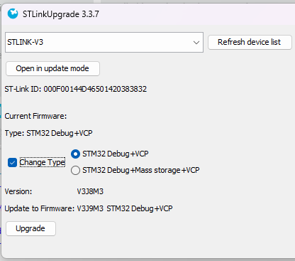

Do the update on a machine with latest CubeIDE or CubeProgrammer - even if this is a Windows machine.
Click on Open in update mode then Change Type.
Note, while in the update mode, the ST-LINK disconnects and turns into a different USB device with PID =374D and single interface (DFU?)
