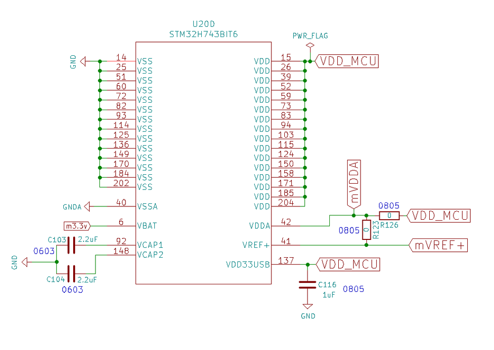

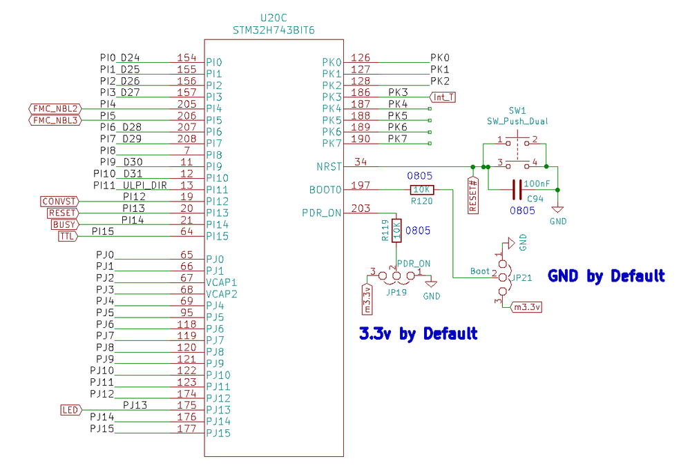

I am not able to connect my new custom board based on STM32H743BI with STM32CubeProgrammer using STLINK-V3SET. and get the "Error: No STM32 target found" when i try to connect.
As suggested in different threads i have confirmed the following:
I am using a 10 pin SWD connector.
The Circuit diagram is shown below
Thanks,
2021-05-08 7:47 AM
2021-05-08 7:47 AM
2021-05-09 3:40 AM
J10 seems inverted to most other SWJ 10 pin layouts.
2021-05-09 8:57 AM
Thank You so much.....
You made my day.
it was the problem of connector footprint. it was supposed to be mirrored vertically. Now i am able to connect and programmed the MCU.
