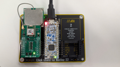

I have the Nucleo-G071RB that I've written code for and using a GPS Click module. There were never any hiccups with the FW running correctly.
I now have this setup as shown below. I ported the code over from the G071RB to this G431KB project. I do see that the NUCLEO-G431KB does not interrupt consistently every time I plug in the USB connector. I have the FW pass data from the GPS(USART1) to the VCP(USART2). Sometimes the GPS will interrupt and the code will pass the strings to the VCP port and sometimes it doesn't interrupt.

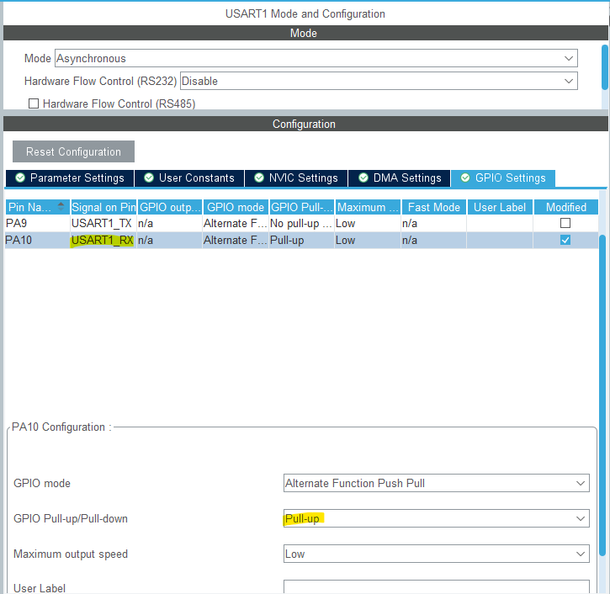

To get both USART1 and USART2 to interrupt consistently, I just enabled pull-up on the RX pins. So give that a try to see if you get interrupts working.
