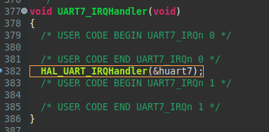

2025-05-03 7:45 AM
basically it should work, but :
- did you enable callback in Cube ?
- on any error uart will stop working - and then..?
You need callback on receive + error :
void HAL_UART_ErrorCallback(UART_HandleTypeDef *huart)
printf("UART7 error testvar hex %ld \n ",testvari);
// *** ... try again
HAL_UART_Receive_IT(&huart7, &ESP_RX[ESP_RX_COUNT], 1);

Set breakpoint in uart int :
looks like:

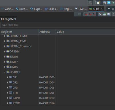

...and look for sfr :
And you always can >pause< debug and look then at sfr , what is set really. (But NOT while cpu is running.)
