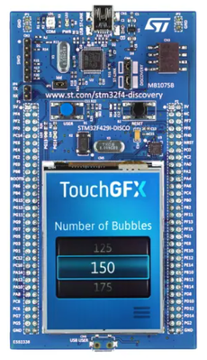

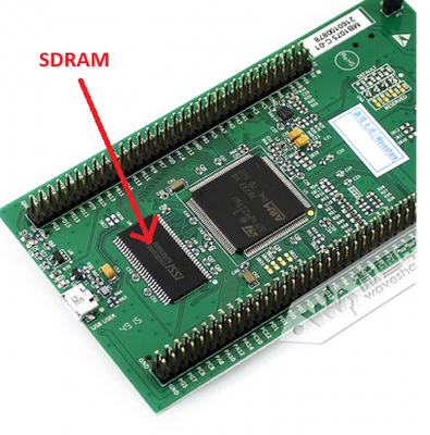

No exactly a ZIO connector (No ST board has both ZIO connector + SDRAM) but I can suggest STM32F429-DISCO board that has an onboard SDRAM + male connectors. almost all pins are exported externally.
Top:
Bottom:

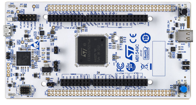

@dish12 wrote:an MCU that has ZIO headers
You mean the double-row Arduino headers? Like this:
That's a feature of the board - not the MCU.
They are found only (I think) on the Nucleo-144 boards.

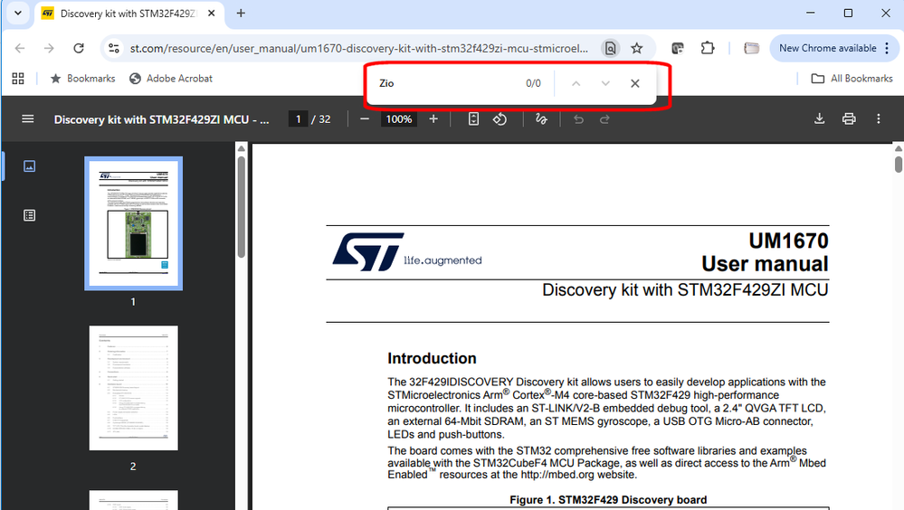

@mƎALLEm wrote:STM32F429-DISCO board that has ... male ZIO connectors.
Does it?
I thought Zio meant the double-row headers on the Arduino layout ?
That disco just has standard 0.1" two-row headers ?
PS:
There is no mention of "Zio" in the STM32F429-DISCO manual:
2025-10-07 10:26 AM

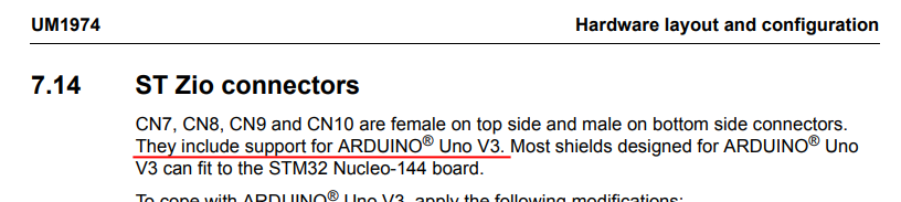

That depends on what the OP means by "ZIO". I think he needs that most of IOs are available on the board.
For the ZIO mentioned in the user manual, I don't think there is a board fitting: Arduino ZIO + SDRAM.
And I think STM32F429-DISCO fits most of the OP requirements.
2025-10-07 10:32 AM
@mƎALLEm wrote:That depends on what the OP means by "ZIO".
Indeed, the OP may be misusing it.
But what ST means by it is the doubled-up Arduino pattern - yes?
