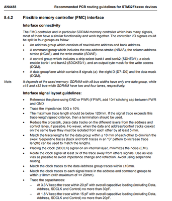

You can take a look at these guidelines for the FMC interface in this Application Note AN4488:
In these guidelines, it is not recommended to use series resistors if you ensure that the transmission line (trace) on the PCB has a controlled characteristic impedance around 50 ohms.
However, if you need further optimization for the signal integrity, you can use series resistors. To determine the exact value, you need to perform a simulation using the IBIS models of the STM32F4.
For this purpose, you can refer to Application Note AN4803, which contains an example showing how to perform a simulation with HyperLynx on an MCU for SDRAM memory using the FMC controller, specifically in section 5.1 HyperLynx simulation with SDRAM.
