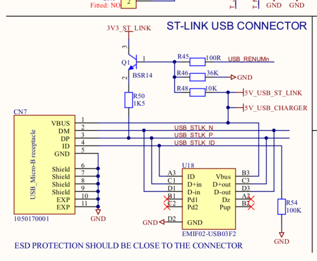

On the other hand, I have been consulting the electrical schematics and noticed a detail, which despite my bewilderment, is perhaps related to my problem.
First of all, a USB-A connector has four wires, and a microUSB-B connector has five. Pin number 4 is not connected.
According to the documentation of my L475E, the fourth pin of the CN7 connector is used for USB_STLK_ID, whose signal will be mixed and filtered together with the differential pair (the data) in U18, to finally be delivered to the STLINK MCU itself.
Maybe my PC does not recognize my micro-controller just because of the absence of this wire on my USB cable? Is it necessary with this IoT node model to buy an interface?
