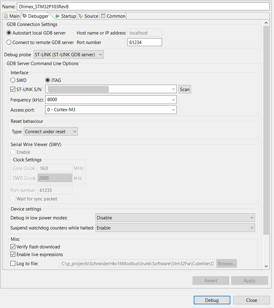

I have an issue with the Nucleo-G474RE, I can't get the JTAG to work, I tried JTAG in 4-pin and 5-Pin-Mode, the IDE reports "No device found on target". With SWD it works in ST-Link-GDB-Server-Mode, but not JTAG. I checked JTAG is connected to the onboard StLinkV3 in 5 Pin JTAG-Mode, seems to be fine.
Does someone know the problem, or may can give me some hints on how to solve that issue?
Thank's a lot in advance.
Best Regards, Seppel

Console:
STMicroelectronics ST-LINK GDB server. Version 5.8.0
Copyright (c) 2020, STMicroelectronics. All rights reserved.
Starting server with the following options:
Persistent Mode : Disabled
Logging Level : 1
Listen Port Number : 61234
Status Refresh Delay : 15s
Verbose Mode : Disabled
InitWhile : Enabled
Target no device found
Error in initializing ST-LINK device.
Reason: No device found on target.
Message:
Error in final launch sequence:
Failed to start GDB server
Reason: (4) No device found on target.

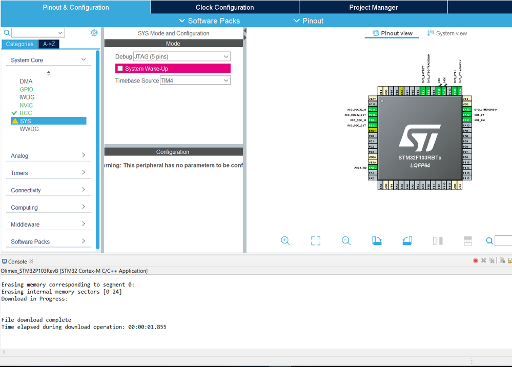

In the Meantime I tried my older STM32F103 Board with a ST-Link-V2, the ST-LINK GDB server works in 5-Pin-JTAG Mode, that works fine.
Does anyone use the JTAG on a Nucleo with 5-Pin JTAG?
Thanks a lot.
Console, all good:
Logging Level : 1
InitWhile : Enabled
Waiting for debugger connection...
Debugger connected
STM32CubeProgrammer v2.7.0-RC1
ST-LINK SN : (confidential)
ST-LINK FW : V2J37S7
Board : --
Voltage : 3.28V
JTAG freq : 1125 KHz
Connect mode: Under Reset
Reset mode : Hardware reset
Device ID : 0x410
Revision ID : Rev X
Device name : STM32F101/F102/F103 Medium-density
Flash size : 128 KBytes
Device type : MCU
Device CPU : Cortex-M3
Memory Programming ...
Opening and parsing file: ST-LINK_GDB_server_a21596.srec
File : ST-LINK_GDB_server_a21596.srec
Address : 0x08000000
Erasing memory corresponding to segment 0:
Erasing internal memory sectors [0 24]
Download in Progress:
File download complete
Time elapsed during download operation: 00:00:01.855
Verifying ...
Download verified successfully

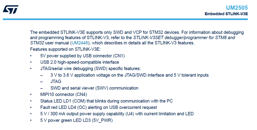

Hi Seppel,
The 4-wire JTAG may not be viable, see Full JTAG configuration without NJTRST pin cannot be used erratum.
However, your problem is different. I don't think many users here use JTAG these days, so don't be surprised if there's no relevant response. Maybe try a known-good JTAG interface which provides better feedback/diagnostics than STLink. Heck, maybe even try the STLINKv2, why not.

thanks for the reply, I may have to do a breakout-Board, I'll keep the "on-Board" ST-Link as it is. I do not gain anything if I use JTAG, but I'm new to the STM32G474, so I thought, ok, I'll give it a try. For the STM32F103 I used 5-Pin-JTAG, I checked the Pinout for the Nucleo-G474RE and set all the Pin's,... surprise, didn't work.
If I have news I'll post it.
