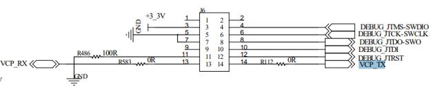

We working on custom board. We using this controller STM32745IIkx. In JTAG we connect the
USART1 port, but there is pin mapping issue, so I am unable to use USART1.So instead of UASART1 can I use USART2.I am sharing its schematic THE VCP_TX and VCP_RX can I use USART2.Please guided me.

I am working on STM32H745iikx controller. I have to use USART for debugging purpose .In JTAG we connect the USART1 .But I cannot use USART1 because that pins alredy assign to another perpherlas, so I need touse USART2 instead of USART1 .So can I use the USART2 as debug port and I can connect it to JTAG or we have to there is rule that we have to use specific USART for debugging or Bootloading.
For debugging you could use any USART, thats up to your code.
For Bootloading (if you want to use ST's builtin factory bootloader) check out this app note , page 261.
It says which usarts the bootloader could use (usart1,2,3) and its mcu pins.

Thank you so much for your guidance. Its helpful.
