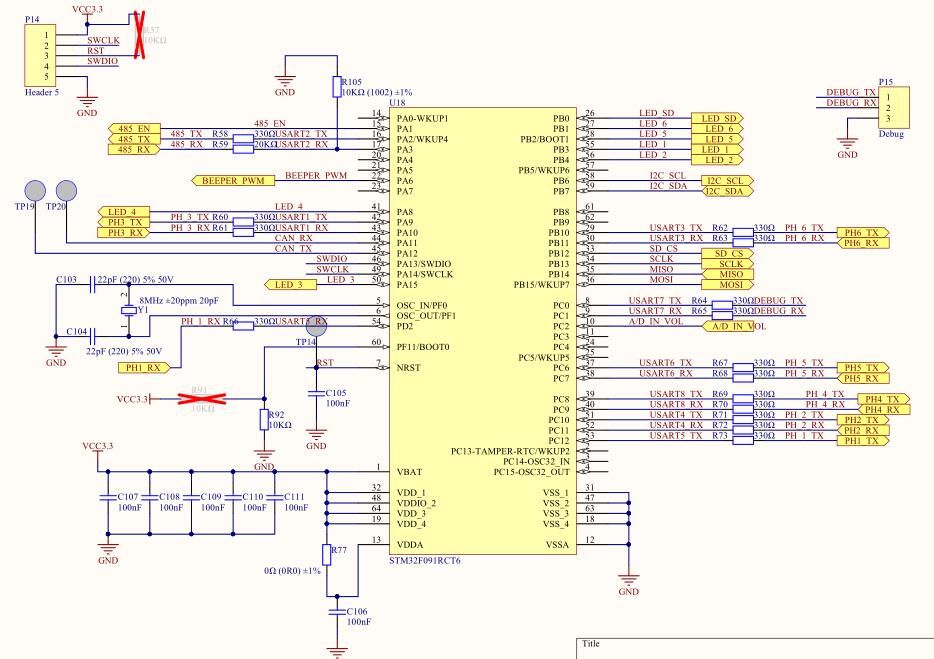

I used stm32f091rct6 in my project. and used keil5, jlink, and stlink too.
There have one problem that JLINK& STLINK can`t find stm32f091rct6 in my board.
Follow is my SCH, it can`t be found too when I soldered one worked chip that was from NUCLEO-F091RC`s board.
What is there any problem in my HW?
2019-09-02 1:59 AM
Did you try to connect under reset?
2019-09-02 2:05 AM
I tried that, but it can`t be found too.
Short reset pin to GND, but the jlink and stlink can`t find chip.
2019-09-02 3:31 AM
Reset should be controlled by the debugger. On some devices, Debug does not react under reset.
