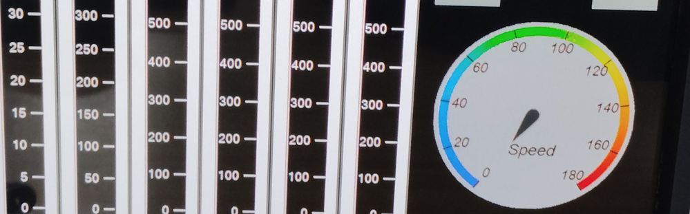

Already mentioned in my first query that the real display is working fine can display text blocks, box, analog meter. display is working fine its totally in my control. Having trouble with touch integration only.
