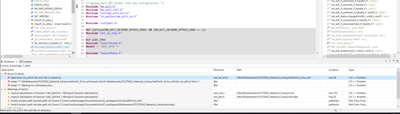

2023-12-21 7:09 AM
fatal error : mx_wifi.h: No such file or director
I added the includes paths as you said but it is missing the parent repertory between workspace and Drivers.

2023-12-21 7:26 AM
Includes
Paths & symbols
Errors
2024-02-01 2:13 AM
If you are on a Windows PC:
don't use too long directory path for the sources.
install the sources in a directory with a short path (near the root folder c:\ )
or create a virtual drive with "subst" command just above "Projects" and open the CubeIDE project from the subst drive.
in a DOS prompt:
subst z: c:\users\username\Documents\stm32workspace\Ww
