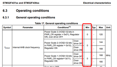

Yes, that is exactly what it says!
You will also find these specifications in the device datasheet.

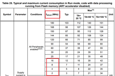

Normally and at least the MCU could start with HSI which is 16Mhz. To me 25MHz as minimum does not make sense. So it smells a bug in CubeMx.
Moreover in the datasheet in Table 25. "Typical and maximum current consumption in Run mode" 2MHz is there.

MCU should clock down to DC.
Suspect the threshold instead relates to some other peripheral, perhaps clocked independently from 48 MHz, like USB, SDIO or CRYP

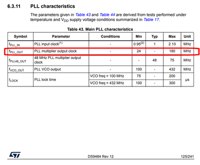

So concur that the minimum must be a dependency on something else ...
@mƎALLEm wrote:
 I need to check internally if this constraint on min HCLK value makes sense and it is not a bug in CubeMx
Maybe it's thinking of this:
