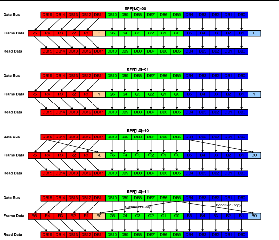

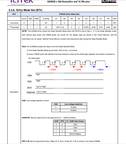

Hi, @AScha.3. Actually, I want 65K colors (16-bit data, R: 5-bit, G: 6-bit, B: 5-bit), so I set the value of EPF [1:0] to 00. Is this the correct value for 16-bit color? i am little stuck..
2024-07-29 2:43 AM
you should not "play around" with settings - until you have it working, just using one of the libs (i showed you..).
565 is the "usual" format (on all libs, i have seen). -> 65K colors
